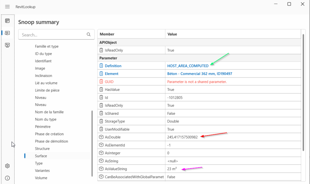

Hello @skyeg3 , to start things off, i would highly recommend taking a look at RevitLookup Tool. It well help you get useful information about how to get the parameters/info of instances, types and much more.
For your case, you would select the element and then snoop the selection. Then go to ParametersSet, there you will find all the parameters of the instance selected.
The image below shows a selected surface. You will search for the Built in parameter in definiton, green arrow (it is Independent of the langue used). After that you can get the exact value (internal units in Revit is Feet) or as a string, in purple, as in your print screen.
To give a clear example, here is a snippet to get the value as a string, where i is one of the selected element got with FilteredElementCollector for example;
i.get_Parameter(BuiltInParameter.HOST_AREA_COMPUTED).AsValueString()
