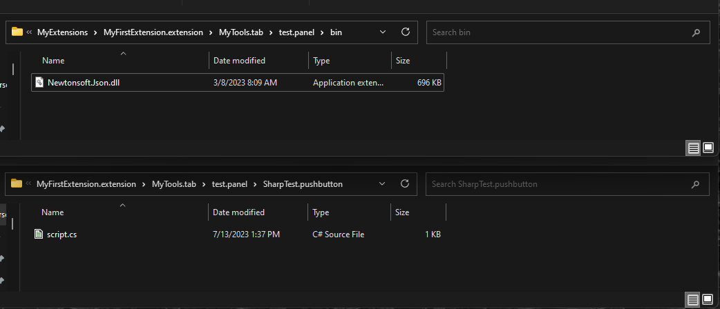

@sanzoghenzo @revitislife I’m still running some issues when loading a .dll from PyRevit.
Say - for the sake of simplicity- I want to just parse a json file using Newtonsoft.Json.dll.
As you can see, I’ve placed the .dll in the bin folder, on the parent of the button:
Here is what script.cs looks like (I’ve tested it and works well on a simple console app):

C:\Users\User\Documents\MyExtensions\MyFirstExtension.extension\MyTools.tab\test.panel\SharpTest.pushbutton\script.cs(4,7): error CS0246: The type or namespace name 'Newtonsoft' could not be found (are you missing a using directive or an assembly reference?)
C:\Users\User\Documents\MyExtensions\MyFirstExtension.extension\MyTools.tab\test.panel\SharpTest.pushbutton\script.cs(24,10): error CS0246: The type or namespace name 'JObject' could not be found (are you missing a using directive or an assembly reference?)
C:\Users\User\Documents\MyExtensions\MyFirstExtension.extension\MyTools.tab\test.panel\SharpTest.pushbutton\script.cs(24,28): error CS0103: The name 'JObject' does not exist in the current context
C:\Users\User\Documents\MyExtensions\MyFirstExtension.extension\MyTools.tab\test.panel\SharpTest.pushbutton\script.cs(26,10): error CS0246: The type or namespace name 'JToken' could not be found (are you missing a using directive or an assembly reference?)
What am I doing wrong?? Do I need to load the assembly in any specific way? I appreciate your help.

The suggestion I gave you was based on the documentation, but after trying to read the source code it could that the bin directory is not detected…
Stupid question: have you reloaded pyRevit (or the entire revit app) after creating the bin folder?
I did tried reloading it, and tried restarting Revit. Doesn’t work :slightly_frowning_face:

check this bundle file in the dev tools extension
and also the CS file. I t might help you
what I generally do is compile the c# command addin as a DLL once compiles I then use the invokebutton to call\invoke the desired class. in my experience that has guaranteed the most consistent results
