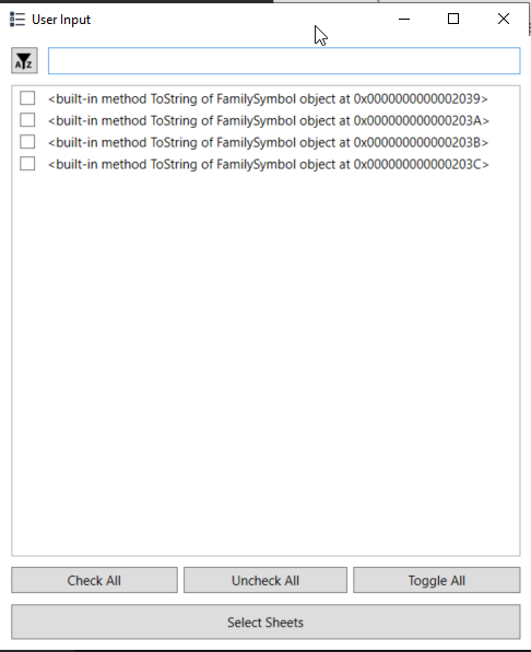

what I am getting is the object itself. like following
how can I get the that family type name amI Doing something wrong with the FilteredElementCollector?

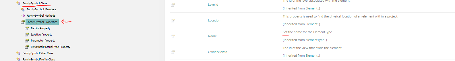

if I am going to the Revit API I can see the following attribute
and I think the name in this case is just a set parameter
