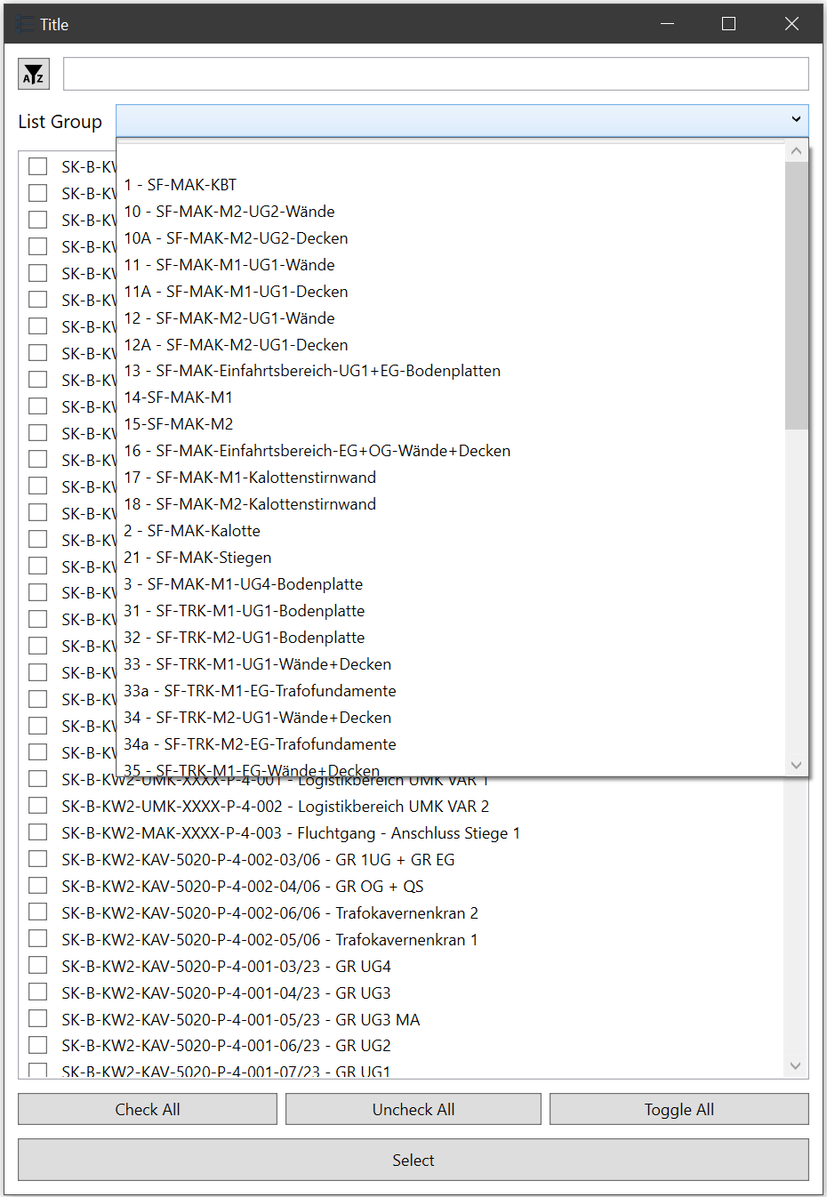

I tried my best but I´m still having trouble with the grouping.
My current result is, that the group names are correct, but if I select a group nothing happens. There are always all sheets displayed.
I’m not grouping by the standard sheetsets like the select-sheets form does, I want to group by a sheet parameter (project browser sorting level). This is why i made a list of the unique parameters and a list of sheet lists by this parameter.

Go it working by ziping sheetsetnames and sheets together :slight_smile:
for SheetSetName, SheetsBySheetSet in zip(SheetSetNames,SheetsBySheetSet):
    sheets = []
    for Sheet in SheetsBySheetSet:
        sheets.append(MyOptionSheet(Sheet))
    ops[SheetSetName] = sheets
But I have the next question.
The order of the groups is alphabetic, so in my case the “ALL” group comes after the groups that start with numbers, so pretty much at the bottom of the list.
Can I change the order of the groups so that the ALL group is always on top?
Oh, now I see that the sorting is pretty bad anyway for my purpose, I will need a natural sort.
I also managed to make a group for the currently opened sheets, would also be nice to have this group on top.
