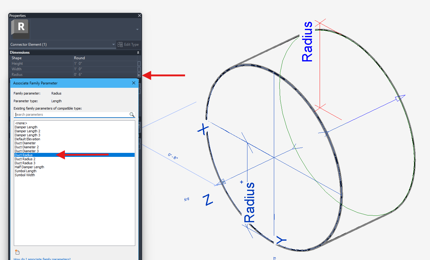

I am needing help with retrieving duct connector associated parameters.
The script below was my attempt in trying to at least find the possible parameters that could be used for the built-in Height, Width, Radius/Diameter parameters for the connectors.

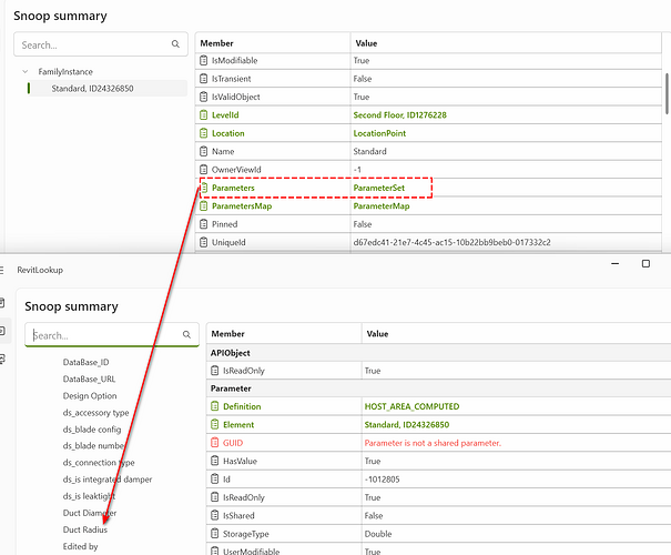

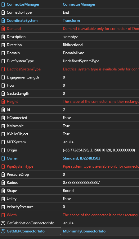

I took a look using the RevitLookup tool and was able to drill down to
MEPModel>ConnectorManager>ConnectorSet but the most i got out of it was Shape, Radius, not the associated created parameter.

So i don’t have an issue looking up the parameter. The issue is retrieving duct connector associated parameters. Looking them up is straightforward.
It’s the “Parameter XYZ” is the parameter associated to the duct connector “Radius” part.
