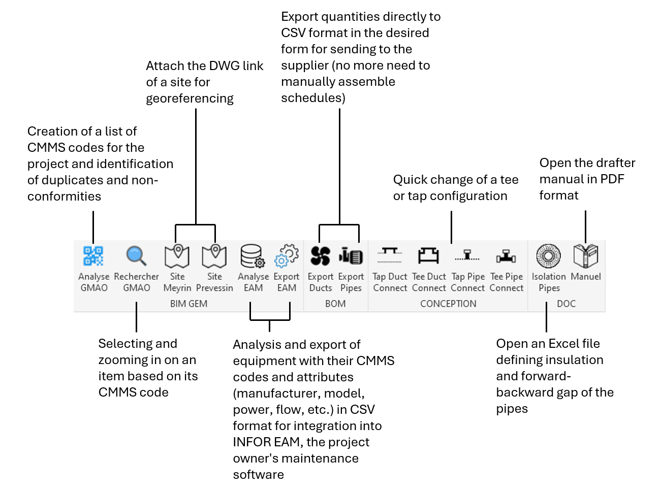

I’m glad to share you my first professional pyRevit bar I deployed for a scientific campus. I was working for an integrated design office into this organisation.
I hope this is not the last and I will have the opportunity of using more and more pyRevit in my futur career !
If you have some questions or remarks don’t hesitate.
Although the commands are mainly specific for my company workflow, I can share you some code about the Tee / Tap configuration wich can be useful for many drafters.
The way to use it is to push on the desired Tee / Tap button before creating your pipe or duct connection, independently of the pipe / duct type.
Enjoy it !
pyRevit_conception
Tap Duct Connect
