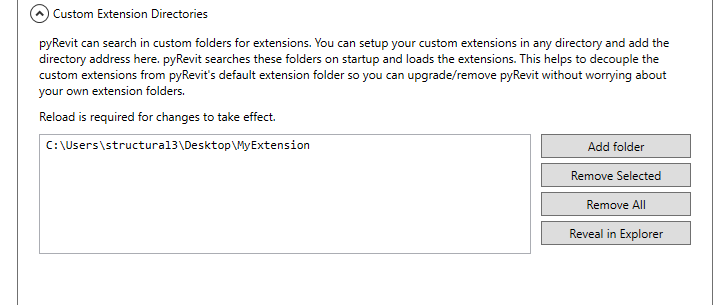

Hi, im trying to make a new command that allows me to export to DWG and have the file name include the revision of the sheet. Ive made the filepath containing the .extension, .tab, .panel and .pushbottom folders with a script.py text file and an icon and ive loaded it in settings. I cant see it in extension or any way to add it in extensions. Can anyone help?
Typical mistake is:
you need to point to the folder containing the .extension folder, not point to the .extension folder itself

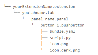

here is a sample with only one button
yourExtensionName.extension.zip (4.6 KB)
thats how i have it.
Ok i used yours and it worked, so im not sure whats wrong with my one
check each folder name and imbrication, this is also typical to get mixed up.
