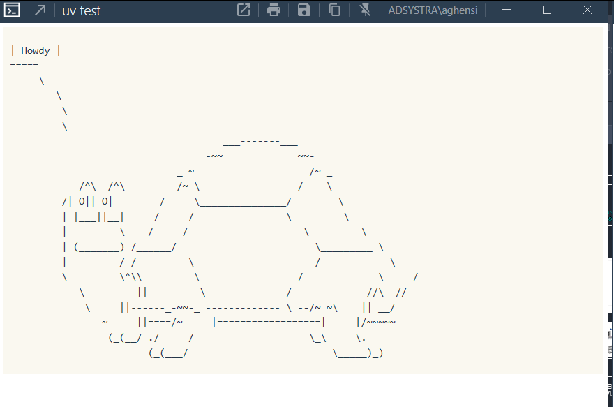

and the script for the pushbutton:
import os
from pyrevit.script import get_output
from uv_interop import run_uv_script
script_path = os.path.join(os.path.dirname(__file__), "cpython_example.py")
result = run_uv_script(script_path, "Howdy", "--animal", "turtle")
get_output().print_code(result)
Here’s the result :wink: (it seems that the pyrevit output messes with leading whitespaces, but you get the idea)
As stated in the docstring, if you add check_uv=true to run_uv_script, it will check for uv presence and install it for you, but it may be better to create a separate button to set it up once and for all.
Also, while uv is really fast to resolve and install dependencies, it will need some time to create a new ephemeral environment each time the script is run.
For this silly example, my laptop takes almost 7 seconds from the button click to the turtle shown in the output window, so my suggestion is to limit your dependencies and use cpython for heavy calculations!
