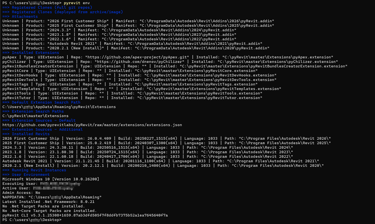

What does pyrevit env returns after install?
Hello Jean-Marc,
Here is what “pyrevit env” returns:
I’m not actually a user of Revit/pyRevit, I am just a sysadmin who is responsible for deploying applications to the environment/workstations. I have the SMEs test with me when I deploy the architectural/construction applications, so any help in debugging this is much appreciated!

before my point #2 and the command:
pyrevit attach CloneName default --installed --allusers
you may be missing :
pyrevit clones add CloneName Path-to-your-pyrevit-directory
if that runs correctly the pyrevit env should return something under attachments
I am interested in that portion

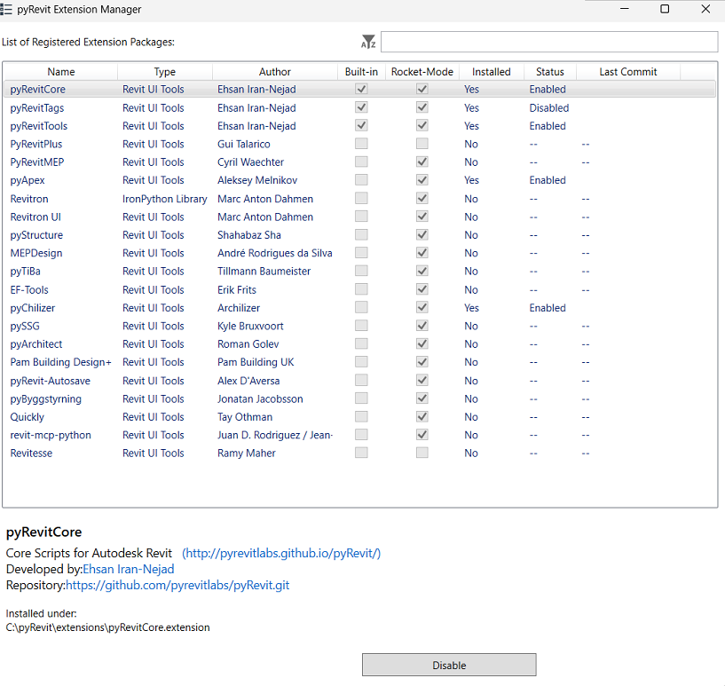

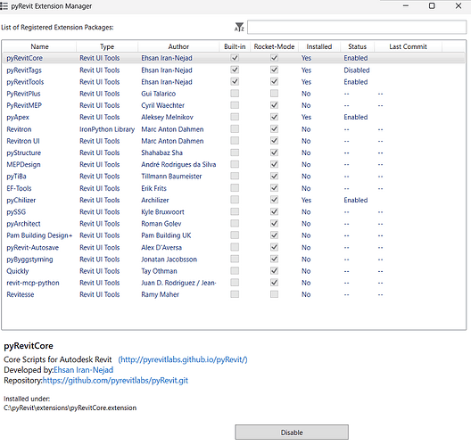

However, for some reason the pyRevit CLI is not installing the pyRevit Bundles Creator plugin and it’s not listed in the plugins section. Do you know what might be causing this?
Your deployment script would be helpful here.
I guess this is because of this list of deployment sets
I could add another one with the bundlecreator extension for convenience, if you like.

Yes, the file I pointed you shows the typical deployments. Here, you are using the ‘base’ one
Hi Jean-Marc,
I now see what you’re saying… OK what is the one that includes the bundles creator?
Thanks!
In the file I linked earlier, there is a deployment key
Under that key, you will find ‘base’ which contraint the list of extensions coming with this deployment.
The bundlecreator is not part of any of the deployments listed in there.
I could add a deployment type, if you need it.
Hi Jean-Marc,
Yes, could you please add it?
Thanks so much!
Added to base deployment
Enjoy
