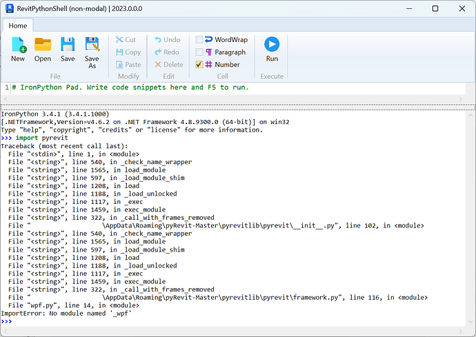

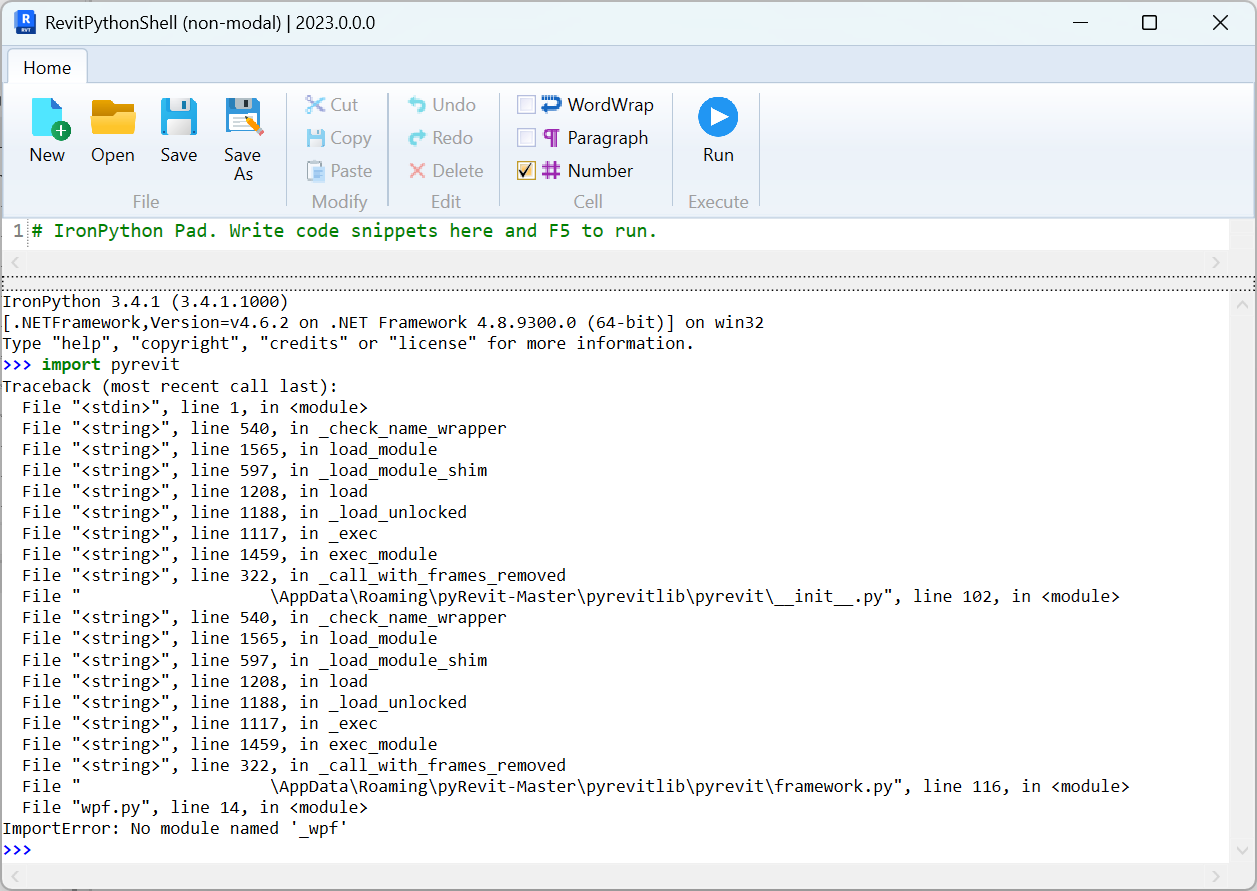

I have had a similar error when trying to import pyRevit in RevitPythonShell in Revit 2023. It works fine in 2025, and my scripts/buttons work in pyRevit.
I had thought the problem was in pyrevit.engine, (line 83 of __init__.py tries to import pyrevit.engine as eng and fails):
  File "<stdin>", line 1, in <module>
  File "<string>", line 540, in _check_name_wrapper
  File "<string>", line 1565, in load_module
  File "<string>", line 597, in _load_module_shim
  File "<string>", line 1208, in load
  File "<string>", line 1188, in _load_unlocked
  File "<string>", line 1117, in _exec
  File "<string>", line 1459, in exec_module
  File "<string>", line 322, in _call_with_frames_removed
  File "C:\Users\s.williams\AppData\Roaming\pyRevit-Master\pyrevitlib\pyrevit\__init__.py", line 83, in <module>
AttributeError: 'module' object has no attribute 'engine'
However, pasting the contents of engine.py into RPS works.
I started pasting the code from __init__.py into RPS, and it has an error in compat.py on the line __builtins__["unicode"] = str:
  File "<string>", line 25, in <module>
TypeError: 'module' object is not subscriptable
There must have been something in the the switch to .NET 8 for Revit 2025, either in pyRevit or RevitPythonShell. Everything worked fine in v4.8.16.24121 except pyrevit.forms.
