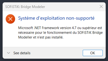

I’ve encountered an issue involving Revit 2025, pyRevit (v5.0.1), and Sofistik Bridge Modeler 2025. When launching Revit, I immediately receive the error shown in the attached screenshot, and the Sofistik add-in fails to load.

  • Can you post the details of the Error? That would help us diagnose exactly what’s happening.

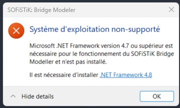

Thanks for this quick reply @Jean-Marc !
I don’t have any more details of the error, the Sofistik Bridge Addin just don’t show up when Revit project was open. The only detail I got when i click “see details” is:
