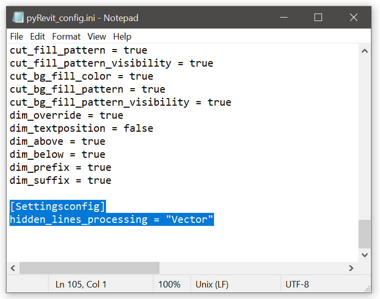

So I built a method to read the .ini file myselfe, not very beautiful…can`t even find a method to get the path of the ini file. But hey, it works…

  • The get_config function allows you to specify a section to access, and it will create a new one for you if it doesn’t exist. If you don’t specify the section, it will use a section usong the command name and the “config” postfix; this is why you see the “Settingsconfig” section and other commands cannot access it.
