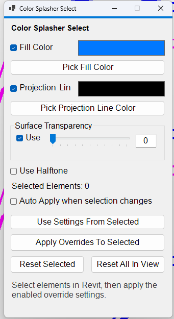

I work in the MEP world and have always had a need for a color splasher tool to color selected elements rather than by category. This made it easy to trace my duct or pipe.
I normally use this for QC/Working views. I wanted to share this and if deemed useful could be included in pyRevit. I tried to share a quick 30 second screen recording of it but don’t now how to.

Here is a what i came up with as the end result.
its a little over 1200 lines of code and the chat doesn’t let me post more than 32000 characters. How do I go about sharing?
