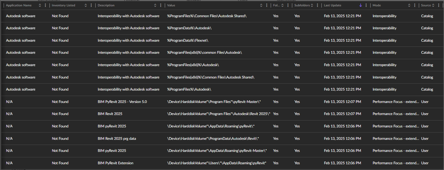

Btw my PyRevit works on 2022 2023 2024, I tested all of them. I have sentinel one but our IT guy did the exception last year and Pyrevit works on previous Revit versions.

It may be a problem with signatures, the dlls were not correcly signed, only the installer was.
It may be solved by adding all the pyrevit*.dll files to the exclusion list of sentinelOne, but I’m just playing the guessing game here

The latest WIP dll are signed, you can give it a try.
