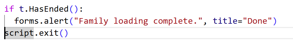

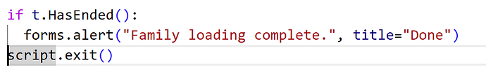

if t.HasEnded():
forms.alert("Family loading complete.", title="Done")
script.exit()
