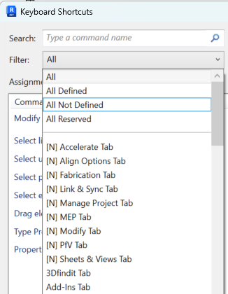

Just came across this thread and thought I would add a note in case anyone else has this issue. It looks like OP has Naviate tools installed. My company just got those also, and I noticed that Naviate creates 9 (!) tabs, even though you may only see one or two. You can see what tabs are actually in the UI by looking in your Keyboard Shortcuts. Here’s a portion of mine for example:
Oh wow!! That makes sense…so it is Naviate!!! Oh my God

What a great idea they had! That leaves 11 for other eventually!
I talked with Symetri about this today.
I notet that they have 7 tabs for Accelerate only. They also told me that in R2025 onwards the [N]Help tab is removed, but they agreed that 7 was a bit much, they just did not have a better solution at the moment.
That said, I agree with them that the limit of 20 tabs set by Autodesk seems very low, espescialy in later years when more and more add-ins are created and sometimes a lot of them are required in projects.
