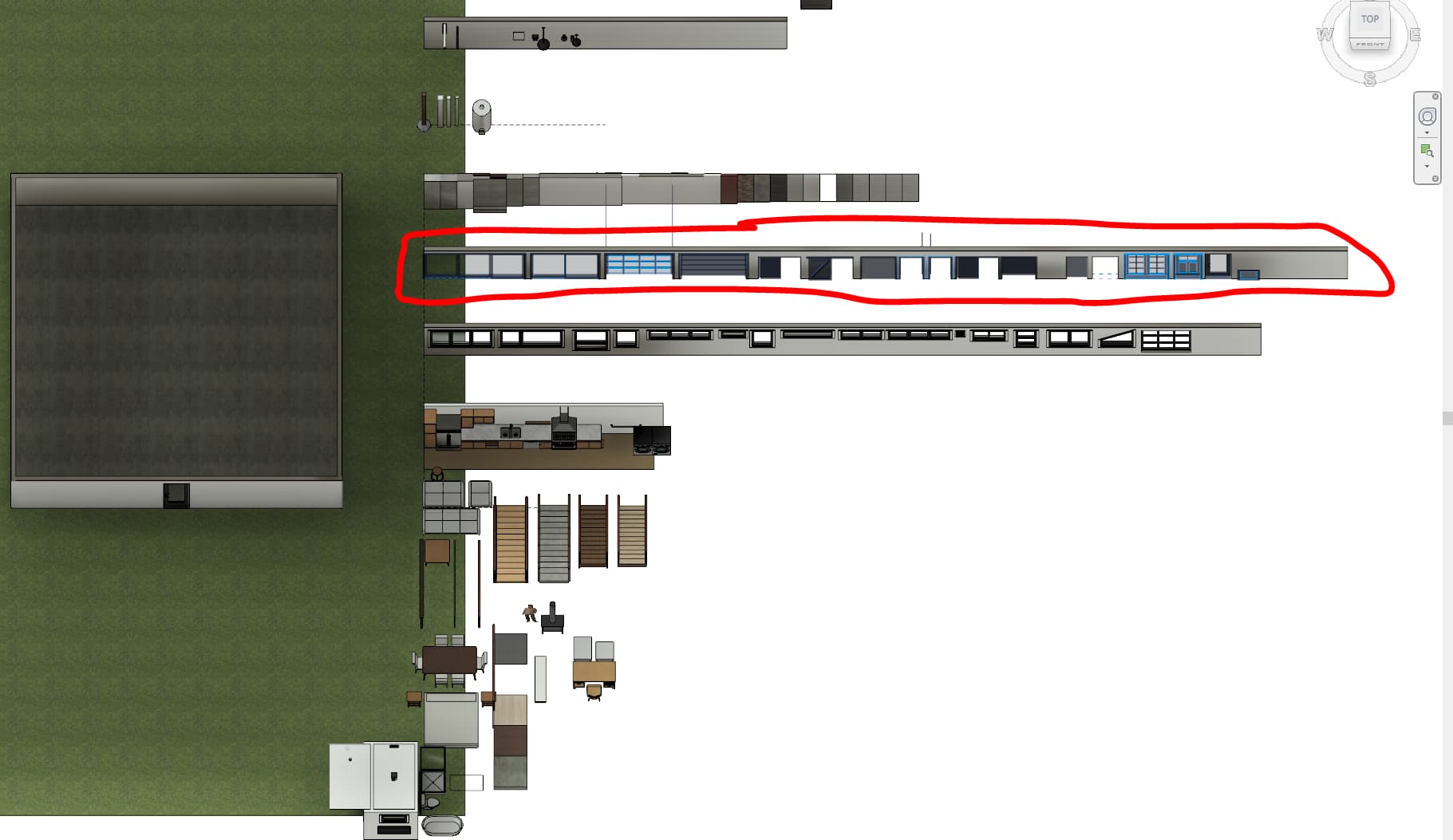

Maybe this tool already exists, but if not could somebody make a wipe selected tool? It would be cool to be able to select a row of doors and just delete them from the entire project all at once.
I may be missing something but I don’t see any tools of his to delete the families from the project. You see, the problem isn’t selection, its removing those families from the project. Say I start a commerial tenant improvement project and I know I won’t need any of my residential door families… I want to just select them all in 3D. (All my families are laid out in 3D in my template) and just remove them from the project. This is in order to lightweight the project. To be clear I want to remove the families from the project. Not simply delete the instances.
