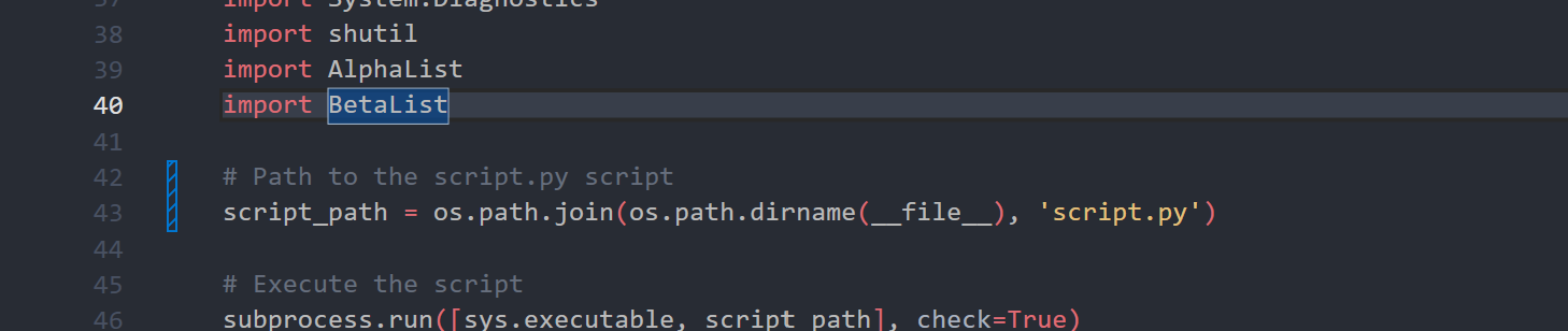

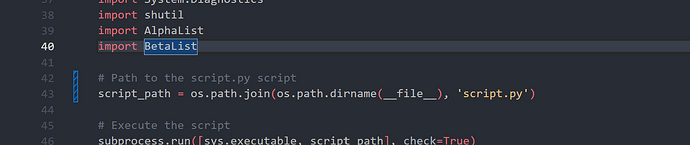

  1. Import the script in startup.py:
The error when clicking the button in Revit states “The target assembly is not set correctly and cannot be loaded”
The dlls exist in the locations specified in the script. How can the problem be resolved?
