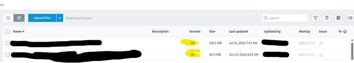

I’m trying to create a schedule for the Revit links that include the file version on BIM 360 but couldn’t find any info in doc that’s helpful

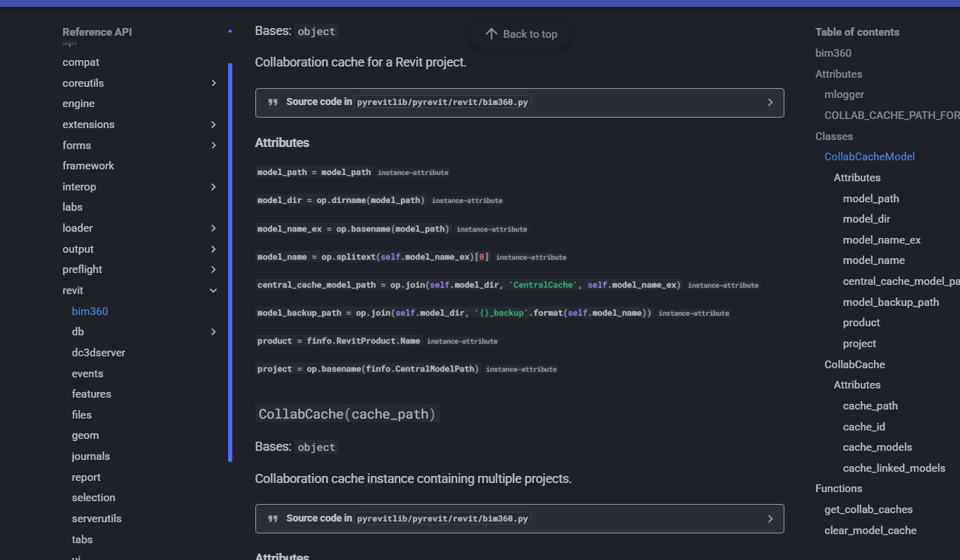

Yes, but not with builtin pyrevit functions. You would need to build your own.
The function you pointed out use the BasicInfoFile class of the Revit API which does not contain this info _ it does contain a version info but it is not related to the BIM360 version _ it is related to the increments of sync of the file
you will need to use the ACC Api to get there, and most probably outside of pyrevit because of the python utilities you may want to use (this one for example acc_sdk/acc_sdk/projects.py at master · realdanielbyrne/acc_sdk · GitHub)

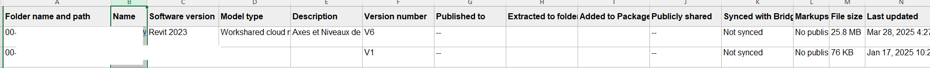

Depending on what is your end game, a simple report export from ACC gives you the version
https://help.autodesk.com/view/DOCS/ENU/?guid=About_Reports
