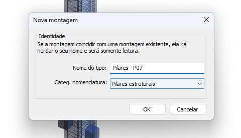

Hello, I’m trying to create a script with Pyrevit where I select several elements to create an Assembly (more specifically a column, rebar, and concrete corbels - which are families of structural framing).
When I create the assembly manually, the type name is required along with the naming category, and it is done correctly [image]. However, with my code, the assembly is generated correctly, but when I try to rename it with AssemblyTypeName, I get the following error: Exception: No valid type for the assembly instance.
Does anyone know what I can do to solve this? Here’s my code.
