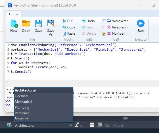

Thank you. I tried exactly that, but when I use ShowElemenets(x) 2 things happen that I’m not happy about: message appears saying “there is no open view that shows any of the highlighted elements…” which I don’t know how to hide in the first place and workset toolbar (at the bottom of Revit UI) is not shown which can confuse Revit users if they run my script. The idea is launch new project without saving to avoid all those clean ups, enable worksharing, create company’s list of worksets and let Revit user manually save to cloud.
The warning dialog is easily suppressed. I’m sure you’ll find posts here in how to do that. I know Jeremy has posted extensively on that as well. You can create the worksheets of course and even initiate the save to cloud for the user.
The worklet option bar should be visible in the UI to the user once the worklets are created.
