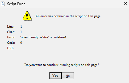

This is the link inside the Linkify Button : revit://outputhelpers/?&command=open_family_editor&element[]=1951262
However, I am getting this error.
How should I structure - where should I place the open_family_editor method?
Currently it is placed in my pyRevit pushbutton script and it works (opens the Family Editor for this specific Family instance) when it is called outside any other logic.
Any help would be highly appreciated as it could open up the door to more interactive output table with such custom command button links at the tip of these buttons.
